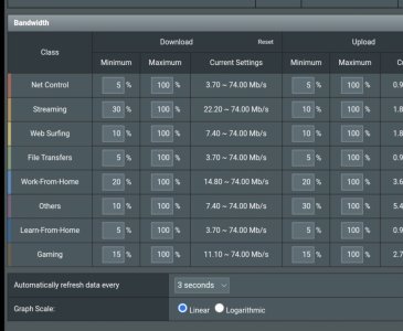

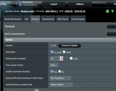

I have attached a picture of the settings I have used so far but I have not changed anything in the device table as of yet as that's just on default settings. Just to see how well FlexQos performs without hardly any modifications done to it.
I used the custom control and made one or 2 adjustments that all .
When I run FlexQos now I get a ratting of C so their is higher latency then when I had cake running as that was A+ .
With Flex is set my DL as 74 and UL as 18 as this is what I got after running speedtest from the router and my mobile device as a consistent result .
Oddly enough even though the latency is still higher than CakeQos it's still miles lower than when I run it without any Qos enabled so I'm still benefiting with using Cake is this a slight tradeoff ???.
So should I change that part of I suppose a bit more latency does impact Flex that much as it's adaptive.
Does this look correct is this wrong or should I try something else .

So does this look correct the screenshot I have attached setup wise for flex ..🤔.
Many thanks as always to the community.🙂👍
it is very strange that with Flexqos you get such a low rank in the tests have you already disabled Flow cache? if I remember correctly Flow cache is a cause of very high bufferbloat on some connections
Thanks For that information..I'm not sure I have I did ask a few times and post some pictures including the above on this thread ...but as usual others so call "hijack" the thread then I had to ask a few times again about what this was originally about my tests and what I posted and needed help with FlexQos ..
Anyhow so many posts later you at least kindly acknowledge what I had kindly asked a few times above ...
Thanks I'll check that and try it again see what happens I'll report back soon. 😊
With the latest FlexQoS script.... if the FC mode is set to Auto & if you add any iptables rules (i.e. gaming or streaming rule etc...) the script will automatically turn off FC.
This will allow for traffic to flow correctly and should improve your buffebloat test score.
