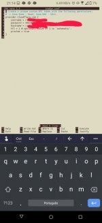

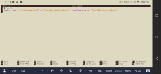

Those are my only two configured files. I don't see a cron job. Are they ok? Or did I miss something?

Because, it doesn't need to run. It runs with ddns-start script. This means that as soon as your router establishes an internet connection, it runs. You don't need to set up any time or frequency. For your WAN ip to change, your internet connection needs to go down momentarily. So, when your router reconnects, inadyn runs.
