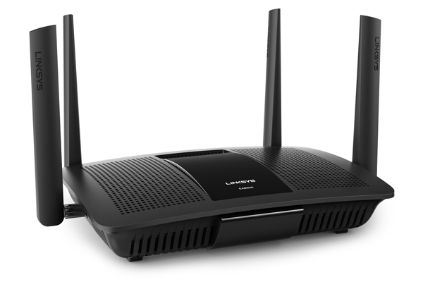

One thing to keep in mind. The EA8500 is NOT a Broadcom router, but Atheros/Qualcomm. That means it's NOT compatible w/ FreshTomato (or Merlin), leaving you one less third-party firmware option for client mode.
But at least in terms of the specs, and according to wikidevi, the EA8500 is slightly better than the RT-AC68U, specifically the processor and memory (although I've heard of some users overclocking the RT-AC68U from 1-1.4GHz).

Flashing EA8500 requires breaking open the router to access serial just for the initial flash. Secondly it was taken off the shelf (looks like it was a steal at Pkr 4250.)
