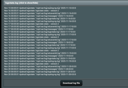

I added spdMerlin and hostapd, along with corresponding log rotate items and see them functioning as expected:
Nov 20 10:52:41 RT-BE88U logrotate: logrotate state -- version 2
Nov 20 10:52:41 RT-BE88U logrotate: "/opt/var/log/wlceventd.log" 2025-11-16-0:5:0
Nov 20 10:52:41 RT-BE88U logrotate: "/opt/var/log/unbound.log" 2025-11-19-0:5:0
Nov 20 10:52:41 RT-BE88U logrotate: "/opt/var/log/messages" 2025-11-20-10:52:32
Nov 20 10:52:41 RT-BE88U logrotate: "/opt/var/log/logrotate.log" 2025-11-15-0:0:0
Nov 20 10:52:41 RT-BE88U logrotate: "/opt/var/log/syslog-ng.log" 2025-11-16-0:5:0
Nov 20 10:52:41 RT-BE88U logrotate: "/opt/var/log/spdmerlin.log" 2025-11-20-10:0:0
Nov 20 10:52:41 RT-BE88U logrotate: "/opt/var/log/hostapd.log" 2025-11-20-10:0:0
The final one that seems chatty enough to warrant a separate log file would be dnsmasq-dhcp[5342], which I imagine the number may change on different routers with different setups. This is the corresponding DHCP requests and acknowledgements, which is normal functionality. This in particular when using Unbound with dnsmasq disabled for DNS resolution. Unless I'm missing it, there is no example for this or it is given a different name.
