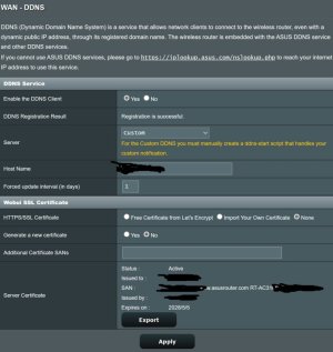

Please excuse if some of my terminology is incorrect. Have been using Merlin on AC3100 for several years, with DDNS enabled selecting "Custom", providing the "dnns-start" script as directed and using Crontab for periodic updates (registered my domain at Afraid.org). Been working as needed for many years. I have MQTT Broker running on a RasPi and a year or so added TLS/CA support via LetsEncrypt. All TLS/CA related stuff is stored on the RasPi, private keys public key and certs. All working well. Router forwards port to RasPi.
Recently had to swap AC3100 routers and basically reconfig from the start. Using a newer version of Merlin, when I got to the WAN-->>DDNS setup page, I noticed where the DropDown box now included "FREEDNS.AFRAID.ORG" so I selected it (instead of Custom), entered my Domain Name, Username, and PW and clicked Apply. Then, not sure if it pre-populated the bottom section Webgui SSL Certificate as a result of me hitting Apply for the top section, or if I did it,
External access to my MQTT Broker is still working, but I see on the DDNS page where FREEDNS.AFRAID.ORG still shows "Free trial"
I am also having an issue there the RasPi can no longer send out an e-mail via EXIM4 due to TLS not validating.
I have since went back and changed DDNS back to Custom, added the script and cron job. Set Webgui SSL to NONE, but the certificate info still populates the screen. Did not fix my Raspi Email issue.
SO MY QUESTIONS are:
1. Should I have stuck with using the older "Custom" way of implementing DDNS or did I do the right thing of selecting the same provider FREEDNS.AFRAID.ORG from the drop down and simply entering my login info since that option is now available?
2. Did doing so add any "certs/keys/etc" to my router that were not there before? If so, how do I use them? The Exim4 log now implies that I am now broadcasting something TLS related, like maybe I am wanting to do a handshake, but not providing the key?
