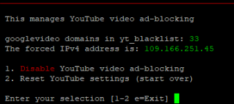

Hi guys. After many attempts to get rid ads, especially Samsung TV Youtube Ads, I can't get any results. Not with Diversion and not with Unbound. My Diversion and pixelserv is installed and running on IP 192.168.50.2 (Router was set to allocate ip from 192.168.50.3 to 192.168.50.xxx and DNS server is set to "Router". All checks from amtm installation of scripts was "green". Can someone tell me what I done wrong?
In you LAN/uiDivstats tab. Under the log can you see your client Samsung IP? Maybe it’s dns is bypassing your setup, can you go into it ( TV) and manually set its Dns server to your router ?
Also what file blocking are you using ? Medium ?
When you amtm/ push 1. Then b, then 8. You can see your yt blacklist,( number of blocked ads) maybe see if it’s working
EDIT: I switch to Full list from Standard and seems to start block ads. I uninstalled Unbound because I have think that is kind of incompatibility with Diversion. Testing now..

Apparently I didn't have Youtube Ad-Blocking active. I managed to activate now and see whats happens.

I have only 33
This numbers increase in time and block more and more ads?
Yes you are correct. Give the remote to the kids for couple hours, or laptop while watching yt. Lol
