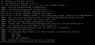

Hello! I am trying to install DNSCrypt but I cant get it to install. I have tried manually through SSH and with AMTM. I always get this error in the end.
What should I do?
What should I do?
Something is happening on your router where dnscrypt proxy.toml is not properly being setup on your router. What model router do you use?
I already formatted my JFFS contents and installed Diversion and Skynet, since I reset my router today. I will try to install DNSCrypt tonight or tomorrow.
Okay, so the error you were seeing was indication that the .toml file did not pass the check, something must have changed recently with the default .toml file that I must take a look at. Either that, or something done in the way your particular install process bugged the installer, so maybe take screen shots of your install process kinda like a step by step that way I can replicate your process.

This line indicates to me that you may be running one of the newer Routers models (a.k.a. AX56u & AX58u)?
Both of these models seems to result in this error when attempting to run dnscrypt proxy.

Yes I am running the AX56U model. Thank you very much for so detailed troubleshooting! I think im going to skip using DNSCrypt, seems like too much of a hassle for me and since AX56U kernel doesnt seem to support it, I dont wanna waste my time trying to install it. Maybe in the future if these models get kernel update.

While I don't have a method to test it, You are welcome to test the patch I just pushed. The problem with those two models as the error suggested, they did not properly drop group privileges. This has been a known situation with Go and some linux model, but I added the capability for Dnscrypt to run without necessity to drop such privileges specifically for the two models in question. The hope being that it will run without a hitch. You are welcome to try it if you like.
Holy smokes. It worked and installed without any errors. Working like a charm. Thank you!

I introduced a new way of running dnscrypt-proxy in a way it was not previously able to on some older kernels. Do me a favor, since I have had absolutely zero time to actually test running it like this, keep an eye on your logs and your internet (dns) performance over the next week of running it, and when you get time, let me know how well it runs. Also, be sure to let me know if there are in hiccups along the way.

Few days been running it now, everything seems to be ok. Only odd thing I keep seeing is that web gui is saying disconnected for internet status, but sometime it comes back with IP and DDNS server name.

Sounds like a false positive, or maybe your chosen servers are not always stable. Maybe try using a different load balance strategy or combination of servers (and/or relays if using relays).
