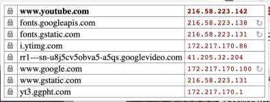

Can you point me to a guide, so i can learn how to get the domains/adresses, etc? I am a novice in these stuff...Any help will be appreciated...
You can install the browser add on for Chrome called IPvFoo and connect to your streaming service and start streaming and it will show all of the web domains being used at that given moment.
Done, in this case for Youtube, i should add all domains i see in the screenshot, right?
So after playing around with de dual wan script. i thought to try this one. All seems to work. But DNS is leaking as far as i can tell. If i add something like dnsleaktest to the site i get different dns's.
So am i being a idiot or do you guys see the same?
Not necessarily all of them, some of those are for ads so not necessary.
