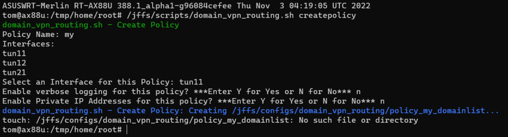

i get errors when creating a policy using 1.4beta. Also wan interfaces are not chooseable.
(i did a clean install, never had a pevious version installed)

I'd recommend upgrading to the latest beta instead of the alpha build you are on and test. I am running 388.1-beta2 on a GT-AX11000 and they are displaying for me.

Sorry for the delay guys, I’ve been out of country and will begin fixing this in the next few days after Christmas. I have already identified the issue just need to update the code and publish.
v1.4-beta1c Release: To use the beta use the following command to replace your production version of the script.
/usr/sbin/curl -s "https://raw.githubusercontent.com/Ranger802004/asusmerlin/main/domain_vpn_routing/domain_vpn_routing_v1.4-beta1.sh" -o "/jffs/scripts/domain_vpn_routing.sh" && chmod 755 /jffs/scripts/domain_vpn_routing.sh
To revert back to production release:
/jffs/scripts/domain_vpn_routing.sh update
Release Notes:
v1.4-beta1c
Enhancements:
- General optimization
- Added the ability to select WAN0 or WAN1 interfaces for a policy
- Added Alias as domain_vpn_routing (For initial load on terminals open during upgrade, execute ". /jffs/configs/profile.add" to load new alias)
Fixes:
- Corrected issue where WAN Interface wouldn't show up if not using Dual WAN Mode
