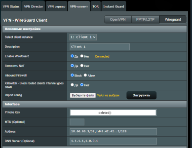

Hello everyone. Help a noob with the setup. VPN Wireguard client is configured on the router.
I want to configure Domain VPN Routing to work only with YouTube via Wireguard.

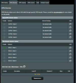

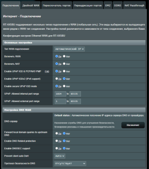

But unfortunately nothing works, youtube doesn't work. Wireguard itself works well and if you add a rule for one of the TVs in vpn director, then youtube will work fine, but then because of the location of my vps in the Netherlands, local iptv falls off. I'm tired of turning on and off the vpn director rule every time.
I attach screenshots of the rest of the settings in the router.

Hi there, how have you setup wireguard? Did you set it to redirect trough VPN Director (Policy Rules) only?
Unlike openvpn, there is no such option in the wireguard client settings

You never did mention if you are routing all youtube related domains, inside of wireguard or wan. Did you select the proper interface? You don't need to do anything else in VPN director if you only have one wireguard instance.
Once you setup domain based routing, goto a computer and do a tracert one of those domains and see how and which interface it goes through. May point to your problem.
