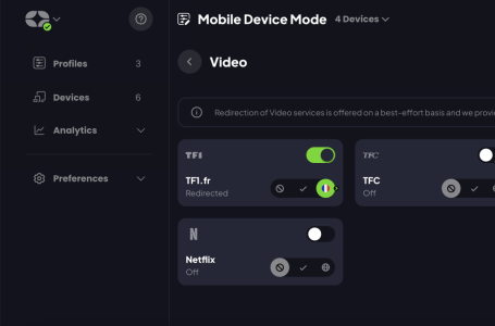

Hi there,
For these cases I end up using controld, it works usually well enough for me… Check the pics… I am in Angola, i setup controld, and I was able to access the site (before I tried, and it was blocked)…
In the case you want to use the script, first check that your VPN is not blacklisted, second install the script and create the policy, add the domains (tf1.fr) and run querypolicy to find the IP's and to create the routes necessary…. Give a few runs to catch and build all the routes necessary to access the site… Be patient…

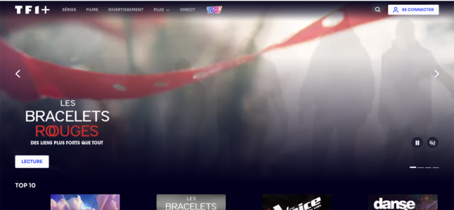

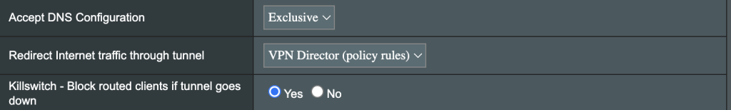

Setup your dns vpn like i did below, and try again...
I tried the following with VPN Director & DNS Exclusive:
  1. No VPN Director Rules
    1. Speedtest.net = Australia
    2. whatismyipaddress.com = Australia
  2. Only 1 rule with no local IP, no remote IP, interface WAN
  3. Only 1 rule with no local IP, no remote IP, interface ovpn1
    1. Speedtest.net = France
    2. whatismyipaddress.com = France
I don't understand how the script and VPN director work together. It feels like the script does not run on my side.

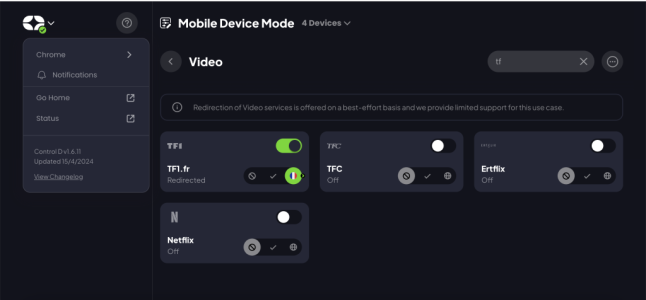

Have you tried the controld option?
I have looked at it, however it kinds of defeat the original purpose. I can install an OpenVPN client to each computer I want to use the VPN and manually connect and disconnect them. With the script it should be seamless as only the url that would be identify would use the VPN.

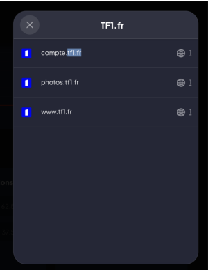

Alright, I have finally found the issue. If, in the script, I enter the domain "tf1.fr" it does not work, however, if I enter "www.tf1.fr" then it works. I would not image that this would be different, but I got that confirmed when I pinged the 2 url (with or without www) and it returns a different IP address.
I learnt a lot, thank you very much!

Interestingly, if anyone like me wants to use tf1.fr replay using OpenVPN, then the following domain should be added:
Policy Name: TF1
Interface: ovpnc1
Verbose Logging: Disabled
Private IP Addresses: Disabled
Domains:
mediainfo.tf1.fr
www.tf1.fr
There is no need to add any rules in VPN Director, and my DNS is set to exclusive.
Just as an information, to watch the video, the domain mediainfo.tf1.fr is actually the one being used to identify the location. I had to use the developer tab of Chrome/Brave and monitor the network to find that domain. That may be useful for some folks who are trying to do the same.
I use IPFoo browser add on to find domains to add via the browser.
