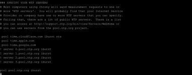

pool 0.us.pool.ntp.org iburst
pool 1.us.pool.ntp.org iburst
pool time1.facebook.com iburst
pool 0.amazon.pool.ntp.org iburst
Remember to restart chronyd after editing the config file. Never mind, I see you already did that.

My DNS provider is cloudflare and cloudflare is also first in my chrony.conf file. I happen to live three blocks from a cloudflare data center. So I guess adding them has caused pool.ntp.org to fall to a lower priority.

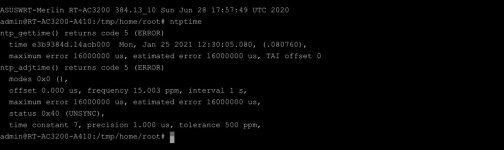

Does this look like it’s running properly? Seems too good.
While I'm not familiar with what version of asuswrt-merlin is the latest for your router, I'm questioning whether the version you're running is compatible with this script.
Have you checked the compato statement in the first post of the ntpMerlin 3.0 thread?
also - error in your first CLI screenshot: I don't think it's meant to be querying the server that relentlessly. have you read the chrony manpage to better config your conf file?
