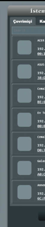

@GNUton
I installed the new alpha. The devices have no pictures :)
