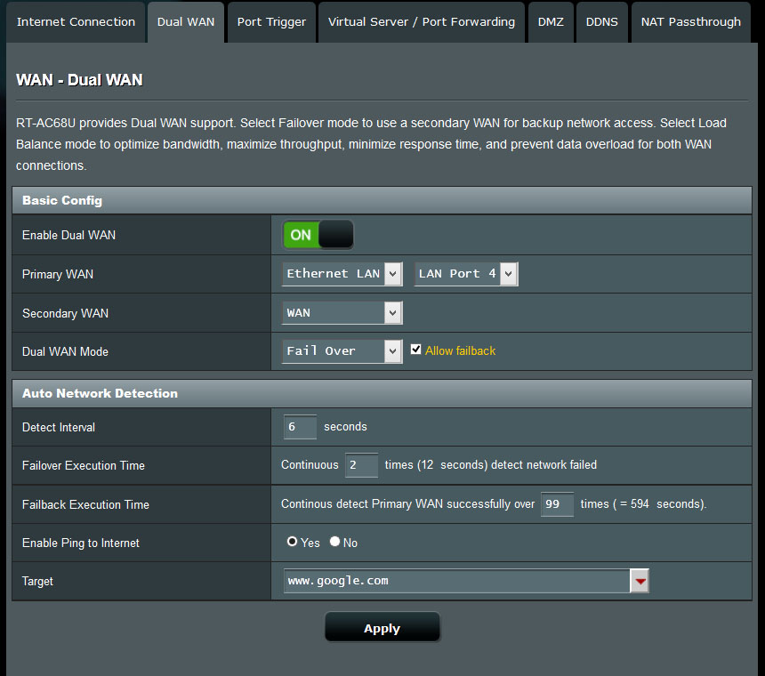

yesterday I found another BUG with Asus DUAL WAN implementation
my primary WAN connection is COAX-cable connection from Vodafone (Vodafone cable modem configured in BRIDGE MODE so it feeds Public IP to ASUS Primary WAN interface - Automatic IP)
secondary WAN connection is Android phone in USB tethering mode
DUAL WAN in Fail-over setup (with fail-back enabled)
due to ISP issues cable modem was not giving any IP to ASUS primary WAN (0.0.0.0)
Asus AC68U with latest MerlinFW (380.60_2) went on jumping between Primary WAN and Secondary WAN
because Primary WAN was "connected" even though IP on Primary WAN interface is 0.0.0.0
fail-over was transferring connection from Primary WAN to Secondary WAN
fail-back was transferring connection from Secondary WAN back to Primary WAN (connected - 0.0.0.0) and
it went into loop, so connection was breaking every 30-60 seconds :(
I did a few restarts, but it didn't help
this is very easy to replicate: connect switch or computer (no dhcp) to Primary WAN (Automatic IP) and let ASUS DualWAN "do the magic" :(
Screenshots from ASUS AC68U
dual wan fail-over went to secondary WAN, should have stayed there until Primary WAN comes properly back

on the computer, connection to Internet is interrupted every 30-60 seconds

daul-wan config
y4mSD-b0LqL289ZSGnkLVBfYxF6iuEYzqPyPrYUXVa836m2a17fQW-XkHU5s378sg6heSNeczGAAtPBXjYm5jL7vQJNORL-aH794hiql4tr3tLkPldwOQ06WmdzTlZzg9DuCcv0tP0NS--naccMoXEpURYKaGU1wN5od9Jo0S0lwnNEsuMtc6X0yVzMTJO5xpMnpOePRmBWAIysKdAQ9MSu9g
going back to primary WAN even though IP is 0.0.0.0

I can confirm that even with the latest Merlin firmware, the RT-AC68 does not check the ping before failback. It will use the ping check for failover, but only looks for physical link status before failback. I dealt with this by making a very sensitive failover, 2 missed pings over 12 seconds, but a long failback setting that comes out to like 10 minutes. So the upshot is that when it fails over, it waits 10 minutes, tries the primary again, and if it doesn't get a good ping in 12 seconds, it will failover to the backup WAN again. So when the primary WAN is down, I get one 12-15 second connection interruption every 10 minutes until the primary is back. That seems to work well enough for me.
