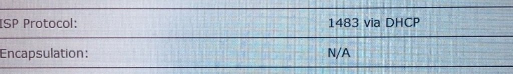

If I knew how to script and ssh and stuff I would give it a go for something to do. Alas I don’t know how. Also I’m not pppoe, I think it’s RFC 1483 protocol iirc?
