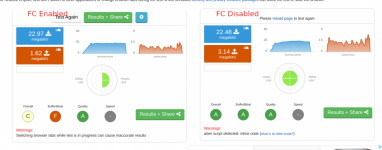

Adaptive qos with manual bandwidth settings on the AX86, Flowcache enabled/disabled.. Just playing around with it again to see if itll ever be as good as the AC86

Your comparison is invalid because one is using one server and the other is using two servers. Configure DSLReports to use a fixed server and a fixed number of streams.

disabling flowcache lets qos work correctly, and bufferbloat is fine now. This only needs done on my AX86, the ac86 works fine period
Disabling flow cache ?? Really?
on the ax yes. The ax does something different. Disabling FC only allows the iptables you can add in flexqos work also. Believe me i spent WAY to much time screwing around with a router to find that out.

yeah because you enabled Cake which disables flow control. i can reproduce this same behaviour there is something funky with the ax86
