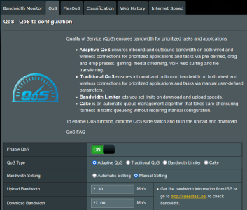

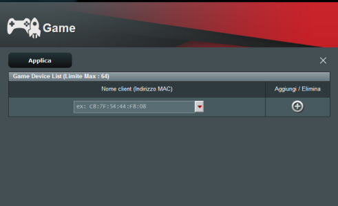

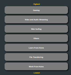

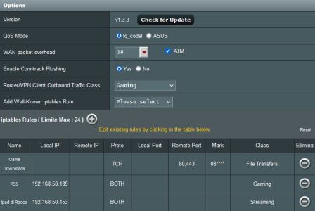

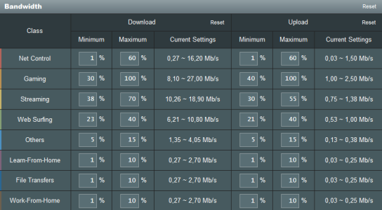

I agree with you on this. I had similar issues when gaming while using CAKE. You mind sharing your FlexQoS setup (sharing screenshots) if you don't mind of course.
Happy to share. As i am now on FTTH i removed FlexQoS just to test connection without any tweak, anyway i can share previous screenshots when i was on a FWA 30/3 where FlexQoS let me game with many other devices on LAN without any pyng spykes, it was a game changer for me. My Bandwidth table it's pretty odd, but it worked smoothly with my previous WAN/LAN configuration as i tracked with traffic classification any rate in realtime and set Bandwidth table consequentially to achieve better performances possible on gaming device.
