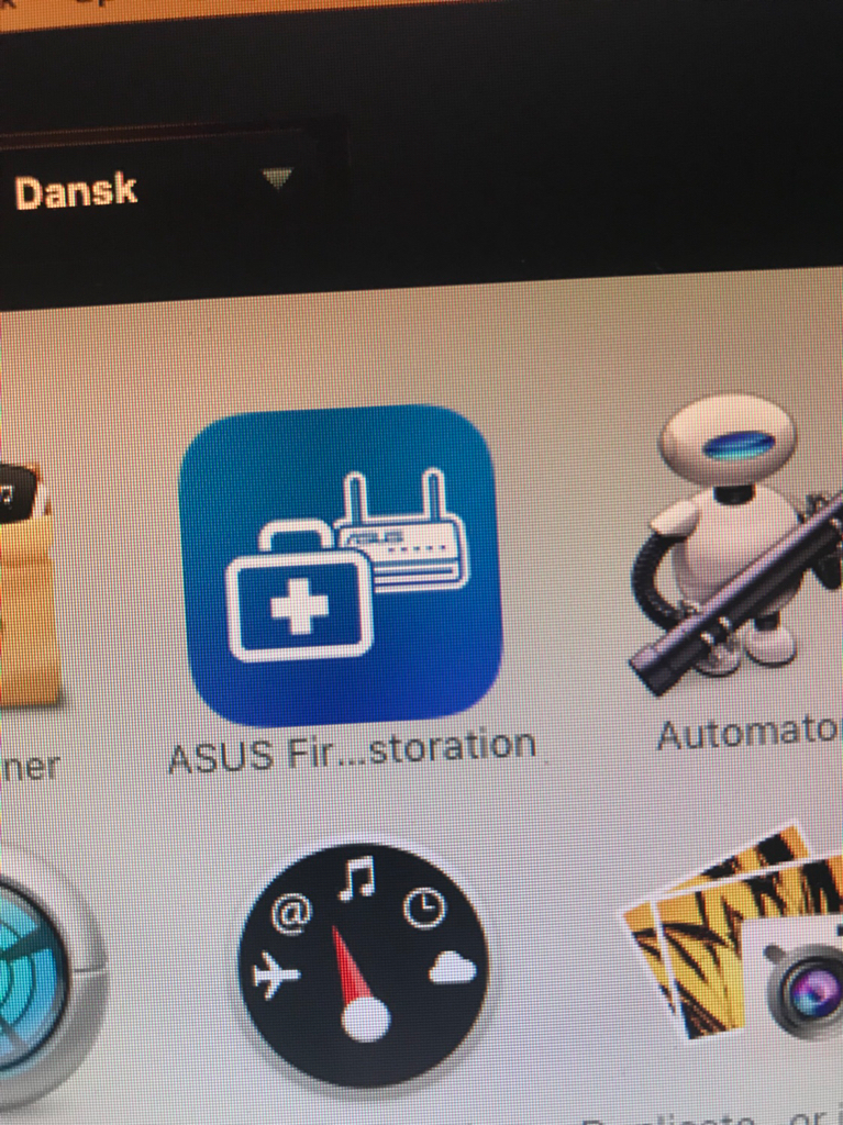

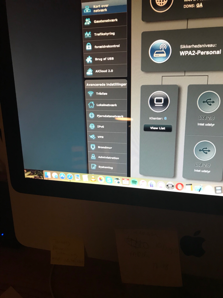

If you dropped back to an older version, then yes, you should be able to update via the webgui to Johns latest build. Just make sure to factory reset in between each flash.
EDIT: wait a minute....... if you are flashing in the recovery webserver, then just flash directly to Johns fork. No need to do a middle flash.
You mean just power it OFF and on again ?
Stop, wait a minute....
EDIT: I am confused, what are you doing? 3.0.0.4.380.7744 is damn near the latest build for your router from Asus, no you cannot flash to Johns fork from this build as it is WAY too new.
Just get to the recovery web server, or the recovery tool and flash John's build from there. That's it.
[emoji33] done nothing yet!!! Yes have the new FW from Asus and i want the Fork again. But dont quit get it do you mean flash it trough safari webbrowser or Asus FW restoraton tool
