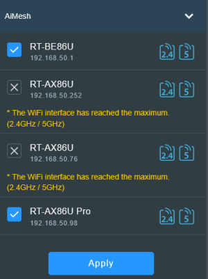

I am also having the problem on Asus Stock firmware:
"The WIFI interface has reached the maximum" but only on my two RT-AX86U, the RT-AX86U PRO is ok as you can see attached file.
how can i solve the problem ?

based on my understanding, it's b/c the primary `RT-BE86U` is running:
ASUS RT-BE86U Firmware version 3.0.0.6.102_37812
The RT-AX86U is:
ASUS RT-AX86 Series(RT-AX86U/RT-AX86S) Firmware version 3.0.0.4.388_24323
And the (working) RT-AX86U Pro is:
ASUS RT-AX86U Pro Firmware version 3.0.0.6.102_34336
TLDR: THe RT-AX86U isn't on the 3.0.0.6 firmware set so it's not going to broadcast other SSIDs.
Not an expert just based on my experience. I upgraded my node RT-AX88U for the same reason to an GT-AX6000 and now I can broadcast other SSIDs without seeing this warning message.

You can't... your hardware has limitations as discussed above.
