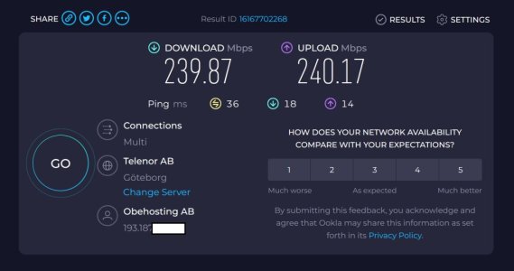

Running the pc version of wireguard client gives around 240Mbps (on a 250Mbps connection). Lets see if RT-AX88 can give the same speeds, the CPU seemed pretty busy, but i think 500 Mbps on router should be possible (my guess). Maybe time to upgrade connection while i am playing around... thx again

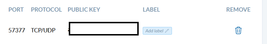

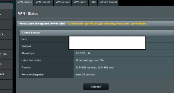

No luck whatever to get connectable. I have open port at VPN provider / restarted connection and wireguard is running.
Still not connectable via torrent for example (works fine with OVPN wireguard client, but not on asus router :(
