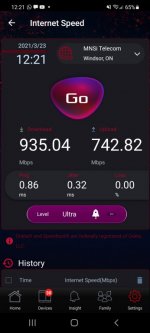

Hi ! From my ISP I get 900 down 700 up.
Latest firmware update for both my gt-ax11000. It's weird when I do a speed test with my samsung s21 I get like 180mbps download and 700mbps upload on wifi.

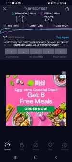

My latest speed test. How can I get so low of a download but extremely high upload on wifi. It makes no sense but when I test with fast.com I get arround 300 mbps download. Also when speed test my pc hooked up wired to the node on basement I only getting like 400mbps download 670 mbps upload.
Its like the download is being slowed down. And yes QOS is off.

Asus are really neglecting this firmware. On either 5GHz channels I'm unable to get over 100Mb/s on a otherwise 940/50 connection. Sometimes it will burst up to 400 and it did the first time I disabled Wi-Fi 6, but that performance vanished again. I'm ready to dump this thing and asus.

Interesting only your upload speeds are performing as they should.

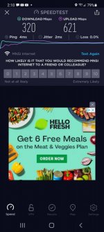

Hi ! Yea I am on the same boat. I was told by asus that the next firmware update will solve this. Don't get me wrong All my 38 devices connected are running super smoothly. My daughter is in online schooling every day we stream 4k videos gaming on ps5 light switches etc... but is just so weird. Actually I changed my 5ghz channel to 40 and I have seen a bit of a jump and stability. I have seen the connection speed test from My s21 at 345mbps Down 700 up on wifi. Man ! Just crazy how is the download so low compared to the upload. Yea ! They need a better firmware update for sure.
I being reporting to asus daily and they being responding! They are aware of the problem and they are working on a firmware update. Let's hope soon. I will keep you guys up to date.
Changed the aimesh 5ghz channel to 40 with better results but still if the upload can do that high I bet we can get the same for download.
