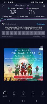

This is a speed test from my gt-ax11000 node in basement its crazy this routers are aimeshed about probably 16 feet apart and lots of walls and they communicate perfectly but still that low download yuck lol
