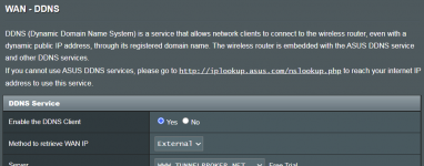

Did you specify "External" for the "Method to retrieve WAN IP" option on the DDNS setup page?
Do you also have an active OpenVPN client running on the router at the same time?

That's why you specify External when configuring DDNS. This causes the router to make an online check w/ a public website to determine the public IP assigned to your *ISP's* WAN, NOT the WAN ip of your ASUS router. Once an attempt is made remotely to access your public IP, it reaches the ISP's router, which then automatically forwards it to your ASUS router on its WAN ip.

The problem is you're using OEM firmware. If you used Merlin instead, you'd have the option to check the public IP *externally*, which means the DDNS client would determine the public IP by making a request to a internet website, rather than relying solely on the *internal* IP as defined on the WAN, which when double-NAT'd means its a *private* IP, and NOT remotely accessible based on that IP.
Perhaps if you chose something other than www.asus.com for your DDNS provider (e.g., freeedns.afraid.org, my personal preference), the external/internal option might become available as an option (I don't know for sure because I don't ever use OEM firmare; it's too limiting).

You need to install Merlin's firmware so that you have the "Method to retrieve WAN IP = External" option. This option is not present in the stock Asus firmware.

OEM firmware doesn't support external checks. However this is something that I've recently discussed with Asus, so I expect it to get added in the future.

This is unrelated. Asuswrt can’t update DDNS with external IP in double NAT. The issue is not in DNS servers used.
