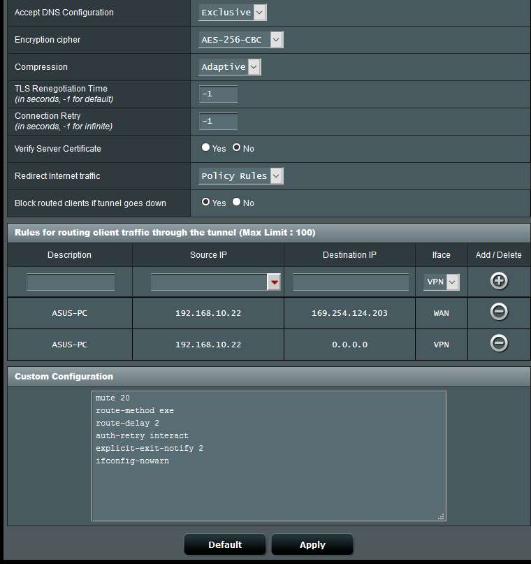

hello, i have purevpn and have problem to setup vpnclient. i used this tutorial but if i goes to whatismyipaddress still showing my real address? https://support.purevpn.com/an-easy-guide-for-setting-up-openvpn-on-asus-rt-n66u-2
That guide cannot be any clearer. I would suggest you look at your custom configurations. even missing a space will give you a problem.
But if you are still having problems connecting take that openvpn file from purevpn and open it up with notepad and copy paste the info in the forum and I can take a look at it and help you further.
this is from router:
http://imagizer.imageshack.com/img922/5703/oydHBg.png
http://imagizer.imageshack.com/img923/8170/1W4r0l.png
http://imagizer.imageshack.com/img923/1665/wdnXLt.png
and this is .ovpn file which i upload to openvpn clients settings...

Hi follow these images and you should connect without any issues.
Just make sure that the certificates are in Authorization Mode/Content modification of Keys & Certificates.
ifconfig-nowarn[/CODE]
Also make sure that you set Redirect Internet traffic to all traffic or policy rules. Do policy rules after you have connected to all traffic and you have a VPN IP
if you need to go to policy rules enable if tunnel goes down drop connection and
setup a rule that does this
source 192.168.1.0/24 destination 0.0.0.0 lface VPN
I would assume your router is 192.168.1.1 for the above rule. if you have a different subnet adjust accordingly
thank you very much....now it is connected over VPN....:) i have another question now....i have to go to sites like real-debrid, furk.net and easynews.org through WAN and not VPN.....how to do that?
EDIT: after setup policy rules i got my real IP address again? what is wrong in my policy rules?
cold boot the router. Turn power off from the wall and leave the on button from the router enabled.
then put the power back on the router and let it boot again.
if this happens again I would default the VPN client and set it up again.
it was not set like that from the begining and you maybe getting a router conflict.
Are you using more then one VPN client enabled at the same time?
Your rule looks fine so long as your router is 192.168.10.1 range and that you went to IP pool and setup the range to be 99 for static and 100 + for DHCP
then you should be fine after the reboot.
