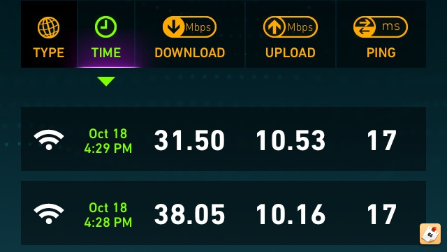

@Craig, one last weird thing I just noticed...I have about 5 servers under the Ookla Speedtest.net umbrella of available servers all listed just by city name that I'm in (which is the same for all), but they are offered by different entities and at physically different locations.
Your PC is probably picking a server based just on the geolocation of its WAN side IP address, but at least my iOS device will use it's approximate real location to pick the server it tests off of. Long story short, it's not difficult to repeatedly and systematically get pointed at different Speedtest servers if you're using a mobile device and also a PC behind the same WAN connection. You can manually go in and adjust them, but even when I look at the list of servers in my city on iOS it groups them alphabetically and not by distance from me. So you have to identify the name of the entity you are testing with and make sure to use that server consistently.
This might not even be your issue, but at least it's an important variable to maintain relative accuracy of your tests.
Here is a screenshot of back to back tests on my iPhone, to two different Speedtest servers in my same city.
