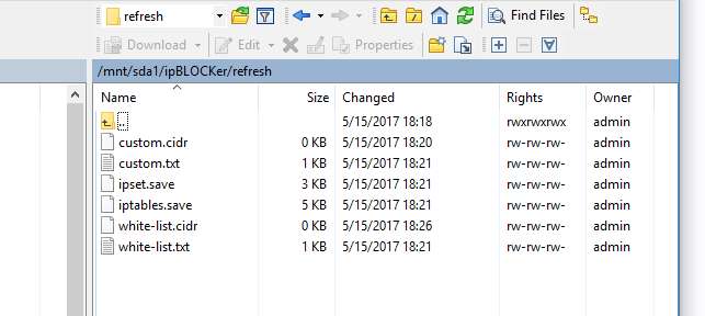

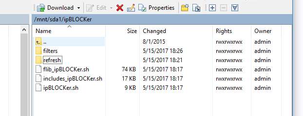

i do block refresh all and got this in syslog.....
May 15 16:38:56 ipBLOCKer: ######################################################################
May 15 16:38:56 ipBLOCKer: Date: Mon May 15 16:38:56 DST 2017      Device: RT-AC3200-7180
May 15 16:38:56 ipBLOCKer:                                ipBLOCKer
May 15 16:38:56 ipBLOCKer:                             (Version: 1.0)
May 15 16:38:56 ipBLOCKer: Memory Status: 81.46M/249.58M      Swap Status: 0.00M/0.00M
May 15 16:38:56 ipBLOCKer: Install: /mnt/sda1/ipBLOCKer
May 15 16:38:56 ipBLOCKer: Filters: /mnt/sda1/ipBLOCKer/filters
May 15 16:38:56 ipBLOCKer: Refresh: /mnt/sda1/ipBLOCKer/refresh
May 15 16:38:56 ipBLOCKer: Backup : /mnt/sda1/ipBLOCKer/backup
May 15 16:38:56 ipBLOCKer: Log    : /tmp/syslog.log
May 15 16:38:56 ipBLOCKer: Space Usage: 13.2M              IPSet Version: ipset v6
May 15 16:38:56 ipBLOCKer: ______________________________________________________________________
May 15 16:38:56 ipBLOCKer:                          Total                  Total
May 15 16:38:56 ipBLOCKer: categories           IP         Hits       CIDR       Hits
May 15 16:39:01 ipBLOCKer: adware               26636      0          0          0
May 15 16:39:05 ipBLOCKer: country              0          0          20116      5
May 15 16:39:09 ipBLOCKer: etf                  22967      0          111        0
May 15 16:39:16 ipBLOCKer: malware              101570     0          0          0
May 15 16:39:20 ipBLOCKer: shalla               5739       0          0          0
May 15 16:39:24 ipBLOCKer: spam                 26352      0          953        0
May 15 16:39:27 ipBLOCKer: tor-exits            7050       0          0          0

i think i have all correctly installed but after reboot all gone.....
from my firewall-start script:
#!/bin/sh
# ipBLOCKer: Restore ipset from backup. DO NOT CHANGE MANUALLY
[ -f /tmp/mnt/sda1/ipBLOCKer/refresh/ipset.save ]    && \
{ logger ipBLOCKer Restoring ipsets...; nice -n4    ipset restore    < /tmp/mnt/sda1/ipBLOCKer/refresh/ipset.save    2> /dev/null & }
# ipBLOCKer: Restore iptables from backup. DO NOT CHANGE MANUALLY
[ -f /tmp/mnt/sda1/ipBLOCKer/refresh/iptables.save ] && \
{ logger ipBLOCKer Restoring iptables...; nice -n4 iptables-restore -c < /tmp/mnt/sda1/ipBLOCKer/refresh/iptables.save 2> /dev/null & }
ASUSWRT-Merlin RT-AC3200 380.66-0 Fri May 12 22:33:24 UTC 2017

i can`t get in? no way.....
admin@RT-AC3200-7180:/tmp/home/root# cd /tmp/mnt/sda1/
admin@RT-AC3200-7180:/tmp/mnt/sda1# cd ipBLOCKer
admin@RT-AC3200-7180:/tmp/mnt/sda1/ipBLOCKer# ./ipBLOCKer uninstall all
-sh: ./ipBLOCKer: not found
I think you should use ./ipBLOCKer.sh
nothing better, Invalid Option
admin@RT-AC3200-7180:/tmp/mnt/sda1/ipBLOCKer# ./ipBLOCKer.sh

You actually need to provide an action command after the name of the script! Valid commands in the output you posted.
In your case:
Once that is done, follow the installation procedure - you should be fine.
it is all fine until router reboot....after reboot not working and can`t access to ipBLOCKer with all commands....i have no idea why script not runing after reboot?
