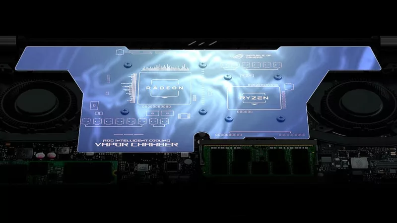

Too bad they didn’t put one of their patented vapor chamber coolers inside:
Of course it would increase the cost/price quite a bit! ;-)
All they have to put is more precise machining of heatsinks actually making contact with ICs surfaces and some quality thermal paste. Few millimeters thick thermal transfer pads commonly used in consumer electronics are a joke. I remember copper shimming of RT-AC86U radio ICs and CPU were dropping the temperatures down with 20C without any fans. Disposable hardware.
