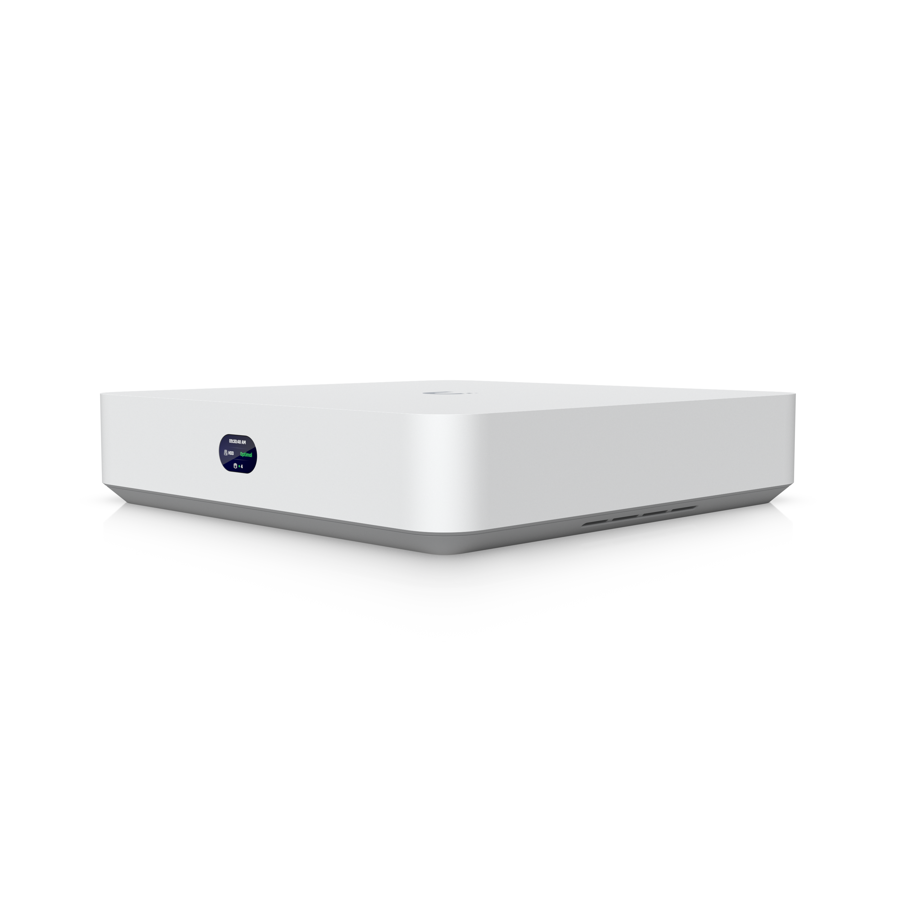

If you want Cameras with Protect sometime in the future - take a look at this new Ubiquiti device (or complete kit):
