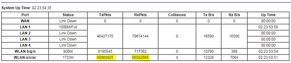

@kamoj and community,
Is there any way for WiFi supervision to determine the TxPkts / RxPkts numbers that are highlighted in yellow in the screen snippet below (from the stock Show Statistics page /RST_statistic.htm) became "stuck" ?
My 5G band on my R7800 in AP mode has dropped after almost 3 days of uptime, and as I've mentioned previously those numbers that are highlighted remain stuck at those values and do not increment as they normally would.
The output from the commands used to check the current status indicate that the radios are on, but the 5G band is actually not showing up on scans from WiFi clients, such as a smartphone running a scanner app.

There is no ath01 and no ath11 device because I don't enable guest WiFi.
I have the Supervise WiFi function enabled and there is no new log entries added to /var/log/kamoj_addons.log since all the radios appear to be on and working, although that is not true.
Any ideas for detecting this "stuck" TxPkts / RxPkts condition on both 2.4G and 5G bands? Thanks.
I've added check of Tx/Rx in the upcoming version. Doing tests now. Thank you for testing and reporting back!

Some observations from trying to get my 5G band to work again without rebooting...
Initially I tried the wlan toggle command-line. It spat out 1 line as shown below, but did not fix the issue:

Finally, I tried the wlan up command-line again and that worked, with output as shown below:

I hope the information will provide additional insight and be useful to your work.
root@R7800:/usr/bin$ wlan toggle

Next, I tried the wlan up command-line and that did not fix the issue, with output as shown below:
root@R7800:/usr/bin$ wlan up

Next, I tried the wlan down command-line and that did not fix the issue, with output as shown below:
root@R7800:/usr/bin$ wlan down
Yes thank you, that is how the test-code is working now.
So let's hope it will work for you as well.
Still we should eventually try to understand the root cause of your problem.
Agreed. It would be great to be able to nail down the root cause for the wlan drops in my case. Thanks.
