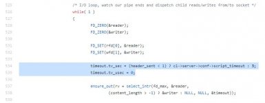

@Voxel,
Please take a look at the code at https://github.com/SVoxel/R7800/blo...77b17e8c3a99/git_home/uhttpd.git/uhttpd-cgi.c
It seems that it is hard-coded for a 3-second timeout after the header is sent, as highlighted in the attached screen snippet.
Would it be possible to fix the code to use the value specified by the "-t seconds" command-line option? Your thoughts?
Not quite so as I understand. Not always 3 seconds. Endless loop:
    int content_length = 0;
    int header_sent = 0;
    int download = 0;
            while( 1 )
                timeout.tv_sec = (header_sent < 1) ? cl->server->conf->script_timeout : 3;
when the value of variable 'header_sent' (initially it is set to '0') could be set to '1'. So initial timeout is set to "-t seconds". Later could be changed to '3' .

So it gives 2 solutions: one requires to not send the header and does not require modified uhttpd.
The other is changing uhttpd.
I personally prefer solution #1, as it does not alter uhttpd and allow possible future support of lighttpd (Orbi, new firmwares...)
Thank you for tests and suggestions.
I agree it's better not change uhttpd.
BUT, the problem without the header is that the size of the response is limited to 4094 bytes.
You can modify your test scripts to return 4095 bytes, which will fail without header.
#Working:
#!/bin/sh
echo "Content-type: text/html"
echo ""
printf "%4095s" |tr " " "X"
#Not working:
So either it's long timeout OR long output.
So long outputs that takes >3 seconds to generate will not work without complicated polling until success.
I don't have solution for this.

Looking on the web, a response header is required, as indicated at these links below:
The solution for the as-is uhttpd is to avoid any delay between the response header and the rest of the response.
For example, the following test.cgi script works, even though it takes longer than 3 seconds and uhttpd returns an HTTP status 500 because of the size of the response:
#!/bin/sh
RESP=$(echo "Content-type: text/html"; echo ""; sleep 4; printf "%4095s" |tr " " "X")
echo $RESP
The browser receives the response as (I've susbstituted "..." for the remaining X's):
The CGI program generated an invalid response:
XXXXXXXXXXXXXXXXXXXXXXX...

@kamoj , like @n1llam1 mentions, the test code you proposed without the header is returning this:
XXXXXXXXXXXXXXXXXXXXXXXXXXXXXXXXXXXXXXXXXXXXXXXXXXXXXXXXXXXXXXXXXXXXXXXXXXXXXXXXXXXXXXXXXXXXXXXXXXXXXXXXXXXXXXXXXXXXXXXXXXXXXXXXXXXXXXXXXXXXXXXXXXXXXXXXXXXXXXXXXXXXXXXXXXXXXXXXXXXXXXXXXXXXXXXXXXXXXXXXXXXXXXXXXXXXXXXXXXXXXXXXXXXXXXXXXXXXXXXXXXXXXXXXXXXXXXXXXXXXXXXXXXXXXXXXXXXXXXXXXXXXXXXX
etc...
With http code 500.
What I do in aegis, is never send a header, and when it returns error 500, I just ignore it and strips "The CGI program generated an invalid response:"
