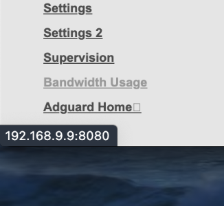

Thank you so much!! Rebooted and worked well, AGH is able to start up after a reboot :) still using your .yaml file, which has alot of block lists and white lists (good idea), username and password is the default x and x but I dont mind, will be using this to test, will do another reboot to be sure, but everything is working :)
I did notice the link to Adguard Home has been fixed after the reboot as well :) it shows the port :8080 before it would just be the main LAN Address.
