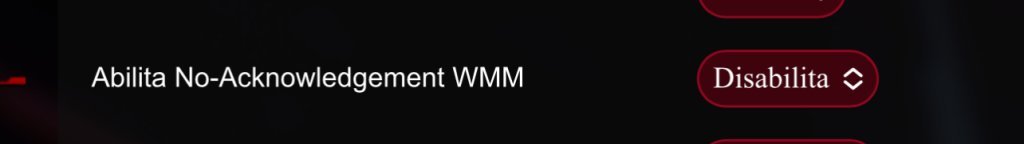

All options active except one:
WMM off
This option (on your attached picture) is disabled by default in Asuswrt.
WMM must be enabled, otherwise the link rates will be cut down to legacy 54Mbps.
Ok.
You can’t set Wmm off.
But i set on wmm (attached image), this cause issue with my robot and xbox.
Xbox’s won’t Connect.
Now all work with wireless option on, before with DSL AX82U, now with BE98.
