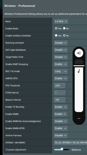

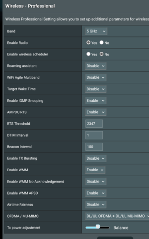

could you send me a picture of your professional tabs for the both bands?
Actually, the size of the apartment or house doesn’t matter, because even if I keep the Wi-Fi device in the same room, it disconnects after one or two hours. The router’s Wi-Fi basically bugs out, and no device can connect anymore. I have several smartphones, laptops, and IoT devices (smart plugs) at home, and all of them have the same issue. So the problem definitely comes from my router.
As requested:
I don't change much from the default. MLO is disabled.
I have less devices than you, but again a good number of wireless devices, including IoT.
As requested:
View attachment 69346View attachment 69347
