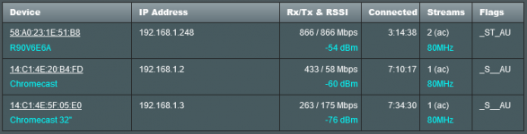

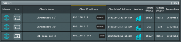

Happens to my AX11000 too but I am not sure if it's 386.4 specific as I didn't pay attention to it. However, a somewhat related issue is that the manually assigned names aren't displayed properly in the Wireless Log. This applies to the older Merlin FWs too even on my AC68U. Maybe it's a coincidence, the affected devices are all DHCP.
