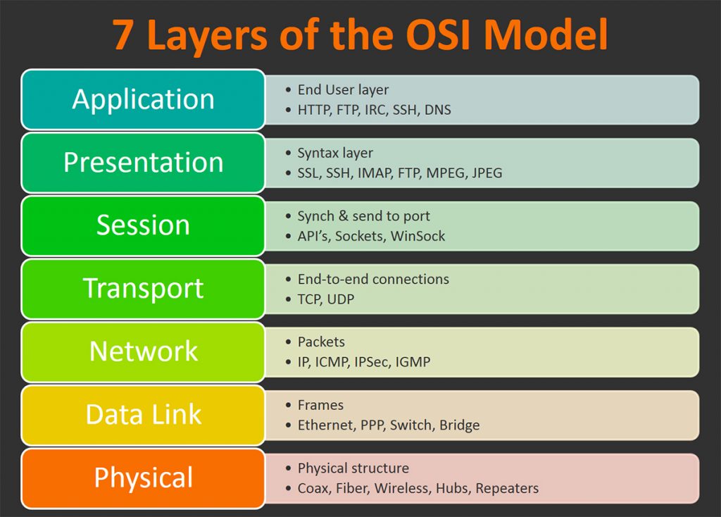

The above shows the 7 layers of networking in the OSI model. This is how computer networking works from the bottom up.
You see where applications are? Level 7. Does that differentiate between games and other latency sensitive applications? NO. Anything that would be sensitive to latency is the same as anything else sensitive to latency. End of story.
You see layer 2 and 3? This is supposedly where the problem is with all these modems. And everything layer 4 and above would be affected by it. There's no special rules for games vs rdp, vnc or the like.
My tunnel between two points is probably one of the best test scenarios since all the routes are static and the only possible causes of excessive latency are on the isp side or my side. Guess what--there's none on either side.
Online gaming has a lot more routes involved, and they are more dynamic. And any time you change your cable modem, you're on a different IP that possibly comes in through a completely different route into your ISPs head-end equipment. Your 'difference' could be somewhere else in your route versus your own modem. Completely plausible and much, much, much more common as a root cause.
This is the problem with this supposed 'issue'--there are a lot of other explanations that are more likely than a mass amount of modems that are 'defective'. Because if this 'defect' was real, the returns alone would cause the product to be flagged in every retailer's inventory management system.
