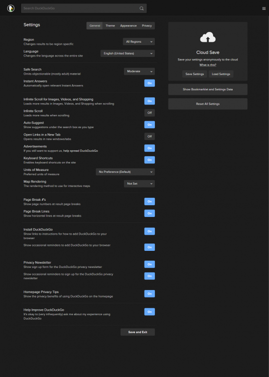

Not sure whether anyone else noticed, but I ran the script @SomeWhereOverTheRainBow created here and searches on duckduckgo.com are now nicely redirected to safe.duckduckgo.com, but when looking at the settings at safe.duckduckgo.com for Safe Search they're still set to Moderate (which is the default setting at duckduckgo.com) instead of Strict results.
Running some test searches still show some graphic results which I like to be blocked. This makes me wonder if the effort we're taking to re-route these searches are having the desired effect. I messaged Duckduckgo to ask for clarification.
It is not going to directly change your default settings it will only control searches at the DNS level.
this is correct.. the setting will say Moderate, but it will actually be Strict.. even if you change the setting to OFF, it will still be strict.. at least this is the way mine works with the script I am using
address=/duckduckgo.com/ 52.149.247.1

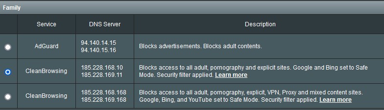

I know this is an old thread I created a long time ago, but I wanted to add something in case someone else ran into this issue with forcing SafeSearch in Duckduckgo.
Since safe.duckduckgo.com IP keeps changing and adding a CNAME hasn't worked for me, I found an easier solution for those who like simplicity.
Just go to the WAN DNS and select CleanBrowsing as the DNS server. It blocks porn and forces SafeSearch on Google, Bing and Duckduckgo.
185.228.168.10
185.228.169.11
Make sure to use this DNS as there are 3 DNS options for CleanBrowsing. One of them makes Youtube strict as well, which blocks comments, which I don't like.
CleanBrowsing takes care of the IP for safe.duckduckgo.com if it ever changes, so you won't have to worry about it.
Also, according to their privacy guidelines, they keep no logs of your queries
