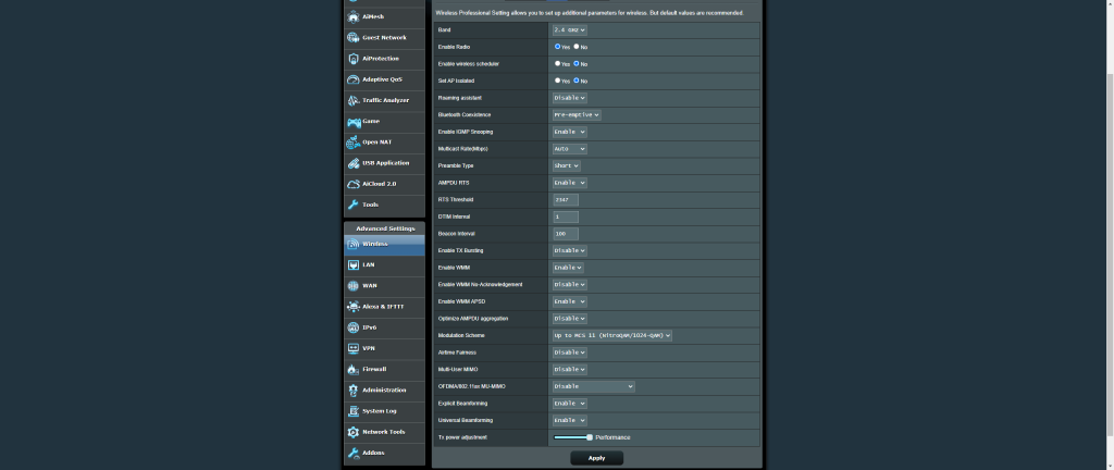

second I do have beamforming in fact here are the professional setting for the 5ghz band
and the 2.4 band
and the 2.4 band
