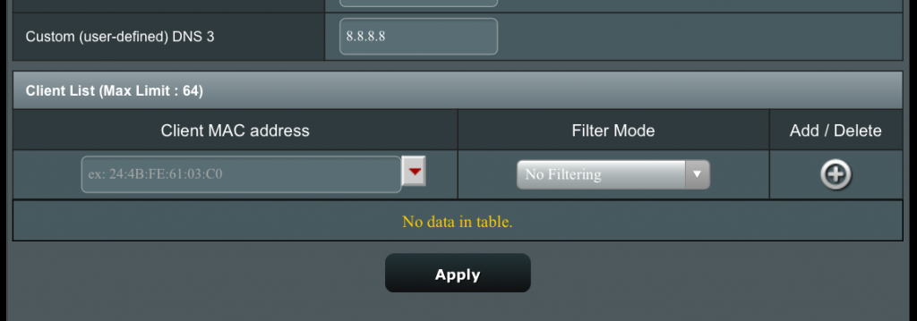

You need one entry only, for the PiHole device, set to No Filtering.
like this...
no wait.. that pic doesn't make any sense... I don't understand what you mean.

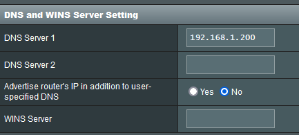

It is probably a good idea, if you are still having issues, to go back and start from scratch (including removing any previous custom changes on the router to run Pi-Hole or other features that were enabled like SafeSearch) on configuring the router settings for Pi-Hole. There were one or two posts on the first page (like mine) that explained how to do an initial basic setup including how to setup the DNS Director section. Do that first and see if things work. Then proceed to modify your settings as needed for your specific needs. Generally is very simple to get a Pi-Hole up and running on the router by inputting the proper information into the LAN DNS and DNS Director sections.
One doesn't need to run Pi-Hole on a "beefier" device, it runs just fine on low power/limited hardware cheap devices like the Raspberry Pi Zero.
What follows are my settings, others may/will have different settings. My settings may not be the best way to do things but they have been working for several years in my use. (Note I do not use Pi-Hole's IP address in my WAN DNS fields.)
LAN > DNS page:
LAN > DNS Director page (note I already have two Pi-Hole MAC addresses input):
Remember to hit the apply button to save your changes on the Asus-Merlin screens.

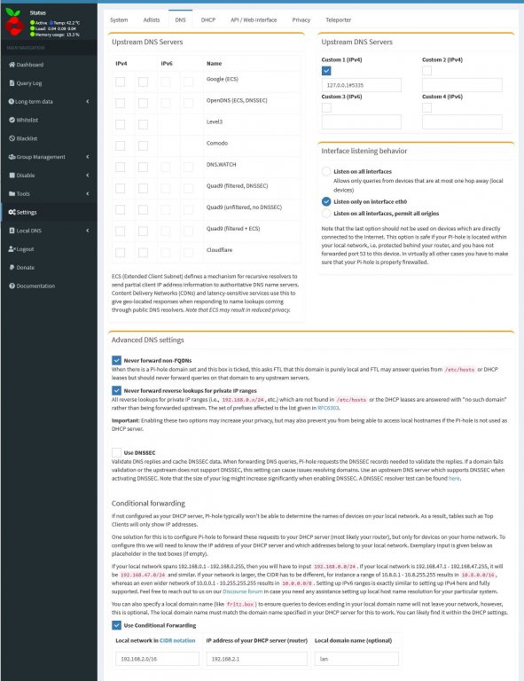

How I have the Pi-Hole DNS settings configured (for my use, your/others may or will be different). I am using Unbound as indicated by the custom DNS.
I'd only disagree with the conditional forwarding.
Mine looks like this and it does in fact use the router for reverse lookups.
I basically have it the same as yours except I am not using unbound as I prefer to use OpenDns.
You disagree with conditional forwarding, yet you have "use conditional forwarding" enabled per your screen capture?
In any case everyone will have different configurations or needs. For the OP the key is to get the basics configured then figure out why specific features or elements they want don't or are not working. Conditional forwarding is what it is. Some use it others don't.
I disagree with your conditional forwarding setting as the router will not provide reverse lookup without that.
