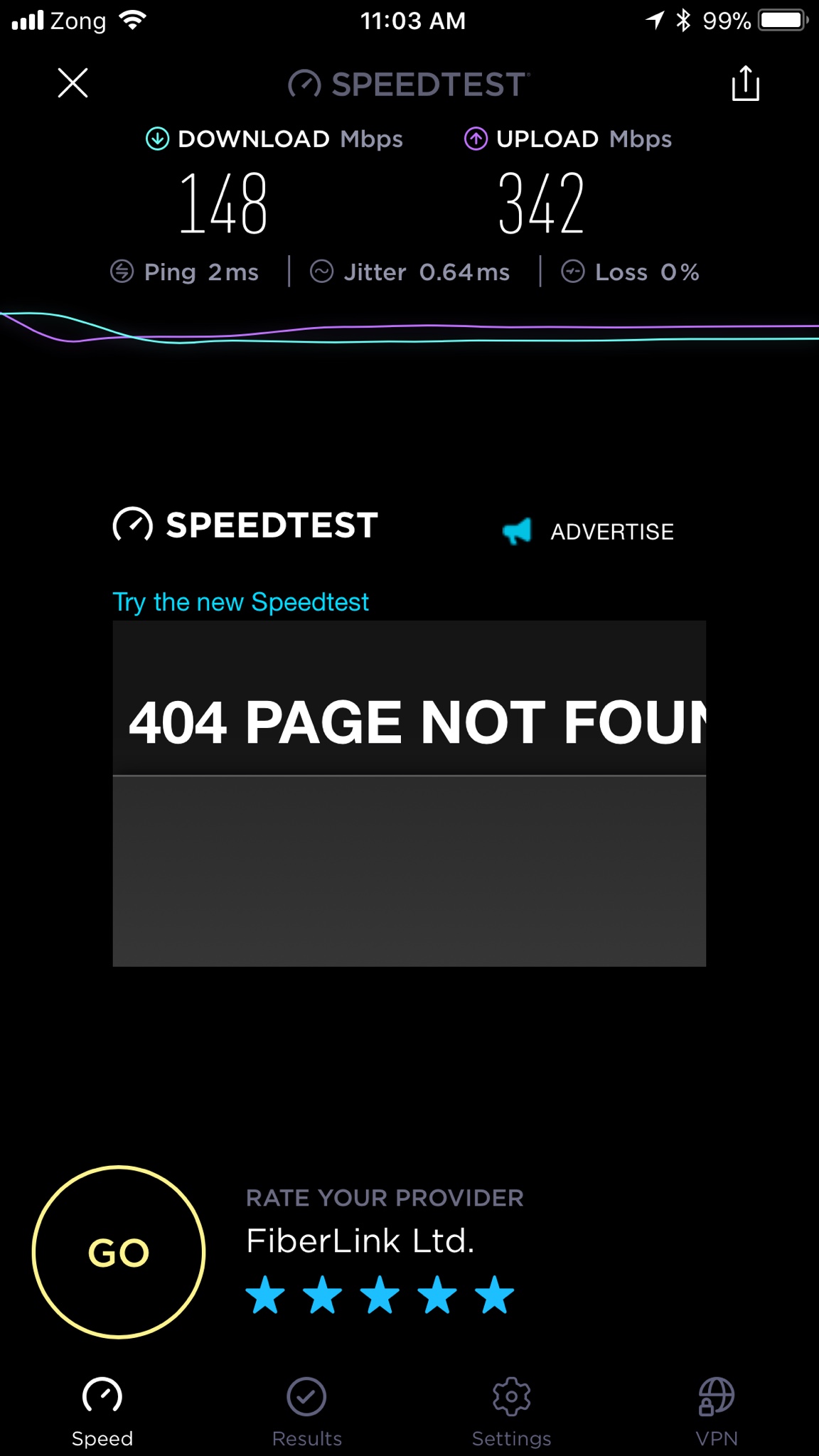

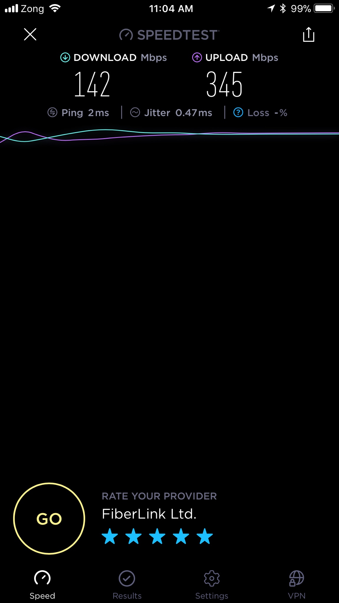

I'm not seeing any ads at all on iPhone and iPad.Hi everyone so after reading the thread throughly I understand that we need to import the certificate on the client devices too ( previously I was using it without importing ) but now I'm getting strange behavior and I don't know if this is the correct place to post it so I'm sorry if it's not.
I'm on iPhone and I regularly use Speedtest.net app and before today I never get any ads popups in the app while I'm using AB-Solution with pixelserv installed ( without importing certificate ) but now it's showing it like the images below ( the ad is still not loaded but it's showing the frames )
