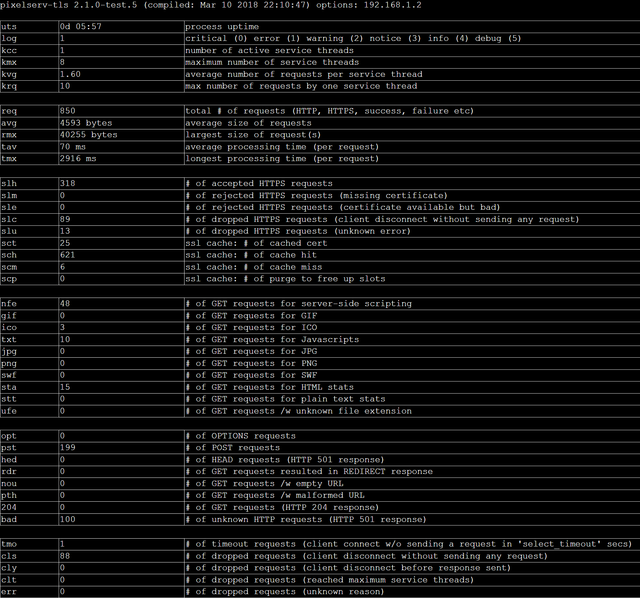

Test 5 running well on my 68U.
Just noticed that my tav is hovering around 70ms..while on the previous tests until now it was about 40ms. Any other 68U users seeing this as well? I know ~30ms is nothing to fret about..just curious to see if this was a trend or just me?
13 hours running. I am getting 40ms as tav.
pixelserv-tls 2.1.0-test.5 (compiled: Mar 10 2018 22:10:47) options: 192.168.2.2 -c 150
uts    0d 13:26    process uptime
log    1    critical (0) error (1) warning (2) notice (3) info (4) debug (5)
kcc    3    number of active service threads
kmx    23    maximum number of service threads
kvg    1.20    average number of requests per service thread
krq    18    max number of requests by one service thread
req    3040    total # of requests (HTTP, HTTPS, success, failure etc)
avg    863 bytes    average size of requests
rmx    11134 bytes    largest size of request(s)
tav    40 ms    average processing time (per request)
tmx    4826 ms    longest processing time (per request)
slh    914    # of accepted HTTPS requests
slm    7    # of rejected HTTPS requests (missing certificate)
sle    0    # of rejected HTTPS requests (certificate available but bad)
slc    628    # of dropped HTTPS requests (client disconnect without sending any request)
slu    542    # of dropped HTTPS requests (unknown error)
sct    116    ssl cache: # of cached cert
sch    1977    ssl cache: # of cache hit
scm    55    ssl cache: # of cache miss
scp    0    ssl cache: # of purge to free up slots
tav is one of the counters that are exponential moving averages ie recent values carrying higher weight. Hence, might be more affected by your recent browsing activities.
The exact curve used in pixelserv-tls is shown below. At each point on x axis, the value on y axis is the weighting. x = 0 is the latest measurement, x = 1 is previous measurement so and so forth.
