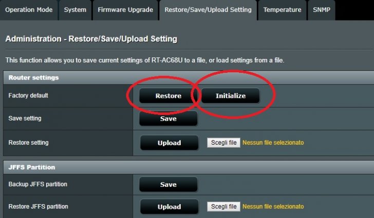

After update use reset to factory defaults with initialize and/or reset button some seconds on backside while turned on, make pictures of all settings/pages, would be easier if you cant remember settings.

Is it possible to solve this contrast? It creates some confusion?
Thank You.
