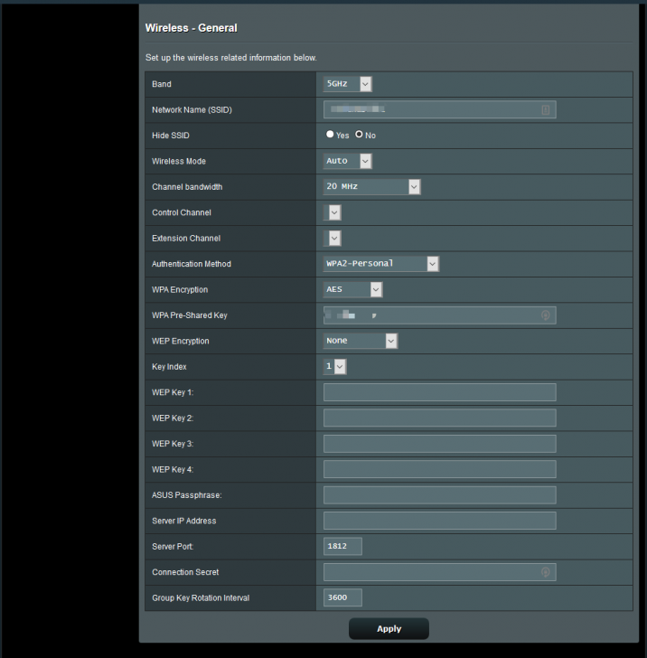

Not sure if it has been reported or not. Running 13_2 on RT-AC87U, when clicking on "Wireless" on the navigation tab, got the following. Note that the navigation tabs are all gone.
That looks like a java script issue browser side. Did you clear your browser cash and do you run NoScript?
This also happened to me when I switched to many configurations in Firefox's About:config
I customized the Firefox Browser so much that I get that screen if I attempt to log into the Asus Merlin GUI. I switched to using Microsoft Edge to log into the GUI and everything works properly now.
