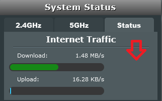

Is there a way to center align the meters or do you plan to use the space to the right for something else.
Or not possible to move them at all?

@RMerlin
I don't know for sure, I'd have to review the actual CSS code involved.

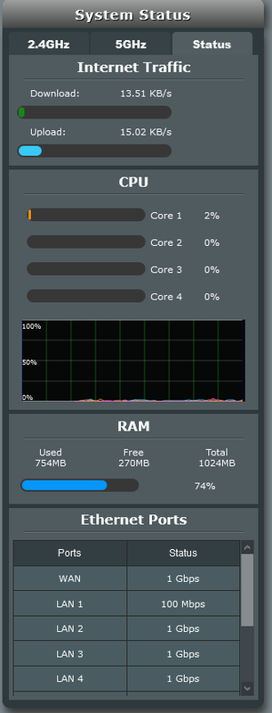

Can someone please post what the new Main GUI on AC86u page looks like..see attached image with RAM chart which i still like to see.
