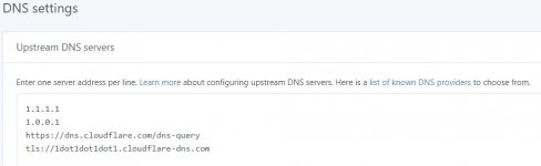

Hello, can someone help me fix this error? So quite I do not know who should listen on this port.
[fatal] couldn't start forwarding DNS server: listening to udp socket: listen udp 0.0.0.0:53: bind: address already in use
Is it possible that this is related to the VPN server (UDP)?
Thanks a lot
Thanks a lot
Well start off by posting the output to this command from your command line
netstat -nlp | grep 53
And
netstat -nlp | grep 553
You may also want to uninstall diversion because this is not intended to run side by side with it and doing such may make an other wise stable router environment operate in an unstable manner.

So now Adguard works so far on the router after DNSCrypt was disabled.
I have now noticed that only simple DNS queries are in the connection log. I assumed that I simply activate a checkbox and the connection is then transmitted encrypted. (Similar to DNYCrypt over amtm) Can it be that this only works if I in
Settings >Encryption settings a certificate?
I have now longer searched but no way found with a Windows pc to create such a certificate, I must admit that I would have but without a Youtube video there difficulties.
Would anyone have instructions for the variant?
lg.
