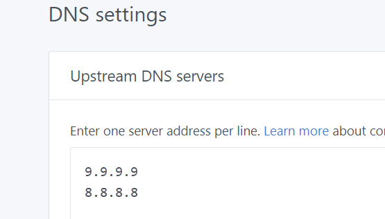

Do I setup my unbound port interface: 127.0.0.1@53535 to both of these AdguardHome Upstream DNS servers?
127.0.0.1:53535
tcp://127.0.0.1:53535
Only for upstream, don't mess with bootstrap.
You can delete 8.8.8.8 and 9.9.9.9 from the upstream section once you add unbound.
Tell adguardhome to use which ever is faster.
So I set the cache size to zero since Adguardhome doesn't have dedicated button for disabling the dns cache.
