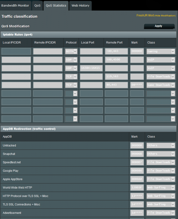

Can you show us the GUI rules you have established? From one of the pictures it doesn't look like you have any. Also on the last image where you put download/upload bandwidth you're not supposed to put the full amount. I put in about 85 to 95% of my speeds.
Edit: The appdb portion doesn't seem to be working either. I mentioned that to @FreshJR awhile back so he could look into it and if possible fix it.
Right, thanks. I did have my speeds set to 90% earlier. Bumped them up at one point to see if it made a difference.
Is this what you meant by GUI rules? It's just all the defaults I believe.
