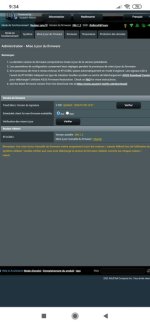

I have a question about last update.
I have a yellow "!" on the top of Asus interface and this in firmware update :
What IS this update ?!?
I just tried to install New firmware 386.9 but After charging it in update interface, routeurs reboot but without applying and on previous firmware 386.7_2
An advise on that ?
