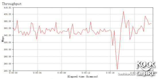

Using PCE-AC68 client, 5G throughput is only ~400Mbps?

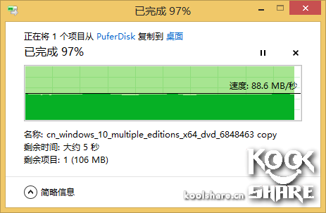

Onboard USB3 read performance is outstanding. 88.6MB/s over wired gigabit ethernet. Note that the attached disk is apparently capable of close to 90MB/s read.

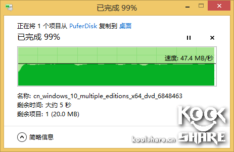

Same test of onboard USB3 read performance but through PCE-AC68 client 1300Mbps link @ 5G band. Drops to 47.4MB/s ...about 379Mbit/s which is consistent with 400Mbit/s throughput test.
5G performance is not outstanding from this guy's test...
