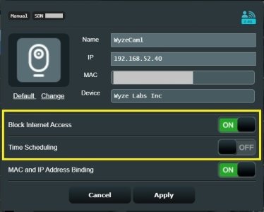

Meanwhile back on topic. As mentioned by @PunchCardBoss in the RT-AX88U Pro Firmware Version 3.0.0.6.102_37421 (2026/03/24). It appears several Guest Network Pro features are either added or finally working in the 3006.102_37421 firmware on the RT-AX86U Pro.
Guest Network Pro client options Block Internet Access and Time Scheduling appear to be selectable and working now. Tested block internet access for a specific Guest Network Pro client and it appeared to work and prevent internet access to/from the specific client.

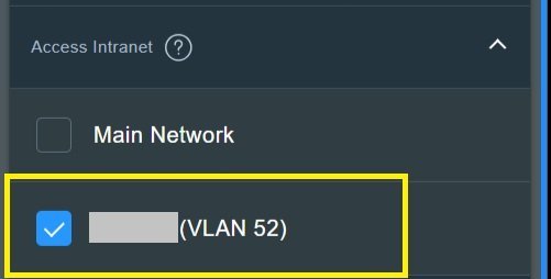

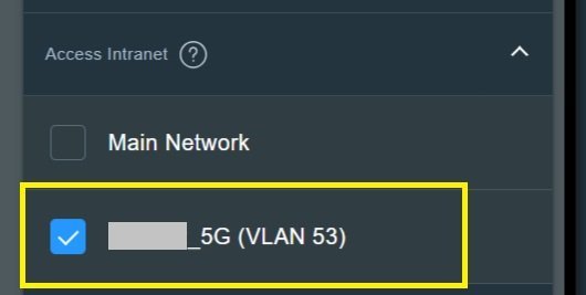

Under the Guest Network Pro profile, Access Intranet now appears to let the user select other Guest Network Pro profiles/VLANs, in addition to selecting the Main LAN. Example that follows is the Advanced Intranet option for one Guest Network Pro profile/VLAN (52) showing my second Guest Network Pro profile/VLAN (53) as selectable.
Edit to add: Quick and dirty test with Access Intranet on VLAN 52 set to only access VLAN 53 (as indicated in prior graphic), clients on each VLAN could ping clients on the other VLAN. In other words a VLAN 52 client could ping a VLAN 53 client and a VLAN 53 client could ping a VLAN 52 client. Neither VLAN could ping Main Network. Also, when selecting the other VLAN in the Access Intranet section it will adjust the other VLAN so it too selects the first VLAN. In example above in VLAN 52's Access Intranet, I selected VLAN 53. When applied in VLAN 53 the Access Intranet option for VLAN 52 was selected automatically. See following example from VLAN 53 with VLAN 52 enabled under Access Intranet.
I do not have HA (Home Assistant) server or HA integration so cannot comment if someone has an HA server on one VLAN that clients on second/additional VLAN's could access the HA server on a different VLAN. Have not tested if it is possible to replicate Asus-Merlin YazFi's one-way to Guest Network feature with this Access Intranet option. This, once Asus-Merlin GPL catches up, could help those who have been using iptables scripting to allow one VLAN to talk to another VLAN.

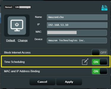

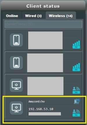

More commentary on on the Network Map > Client popup for Guest Network Pro clients.

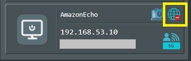

When selecting Time Scheduling for a Guest Network Pro client on the Client popup, when hitting Apply the user is taken to the Time Scheduling page where they can configure the time scheduling for the specific Guest Network Pro client. A quick and dirty test of Time Scheduling showed that it did work to block a specific Guest Network Pro client from the internet at the time specified in the Parental Controls > Time Scheduling section. The time scheduling block is indicated by the third image below.

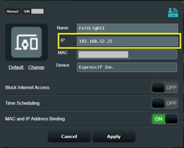

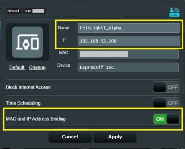

Not sure when Asus fixed or added the ability for the Network Map > Clients information popup field editing, but one can now change the IP address for a Guest Network Pro clients in the popup Client dialog. If I remember right most of the options on that Guest Network Pro Client popup dialog were not editable or changeable in early 3006 firmware on the RT-AX86U Pro. If an MAC and IP address Binding isn't enabled, when setting the IP address it will enable that setting. One can change the Name for the Guest Network Pro client as well in the Client popup. Changes for the Guest Network Pro client are reflected in the Guest Network Pro > Advanced Settings > Manually Assign IP around the DHCP list section. Some screen captures showing the IP address and Name being changed for a Guest Network Pro client in the Network Map > Client popup dialog window. First two shows the IP address being changed in the IP field.
This third image, I previously disabled the MAC and IP Address Binding option and applied the change. Then I changed the IP address to 192.168.52.100 (which enabled the MAC and IP Address Binding option) and changed the Name to Feitlight1_Alpha. The image reflects that change.
With the Guest Network Pro Access Intranet setting. If one sets access to another VLAN. If they access that second VLAN and uncheck the first VLAN's Access Intranet it will in turn uncheck the second VLAN's selection in the first VLAN's Access Intranet section where one first made the selection. Basically, it appears one cannot have a "one-way to guest" between VLAN's with the Access Intranet feature as it currently stands (at least in my quick and dirty testing).
