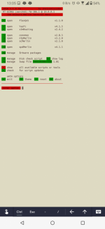

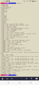

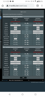

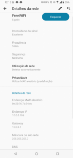

Crap. Everything was working. After a reboot, same problem... Again. Open network connects without yazfi settings.
I think iptables aren't being applied

I want to help but without logs I cannot see what is going on with your boot process.
Looks like FlexQoS is failing for you too: FlexQoS: ERROR! Check /tmp/flexqos_tcrules.log
You also have a lot of spam about buggy protocol on br0 which I haven't seen before. Which scripts are you running?
Try removing nextdns from the equation to start with
